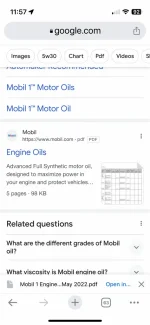

Yes. You can go on the Mobiloil web site and get the spec sheet for all of their oils which lists the zinc and phosphorus levels in ppm.
If this link doesn’t work just Google “Mobil oil specifications”
chrome://external-file/Mobil%201%20Engine%20Oils%20Product%20Guide%20Sheet%20-May%202022.pdf
