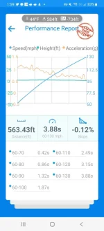

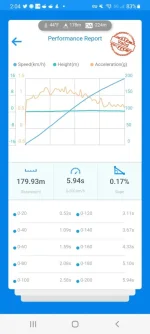

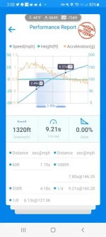

I have a 2018 Audi TTRS that makes about 900whp. I only drive it about 1,000 miles a year, but it gets driven very hard when I do drive it. I do a lot of 60-130 and 1/4 stuff as well as spirited street driving. I don't really care about long OCI's the oil will be changed at least every year and less than 1,000 miles. I don't do any road racing with this car.

Car weighs approximately 3,100lbs. Yes, probably 1000hp at the crank +/-.
I haven't had this setup on the dyno, but I am very familiar with the platform and what hp they make with this Xona 8264s turbo.
