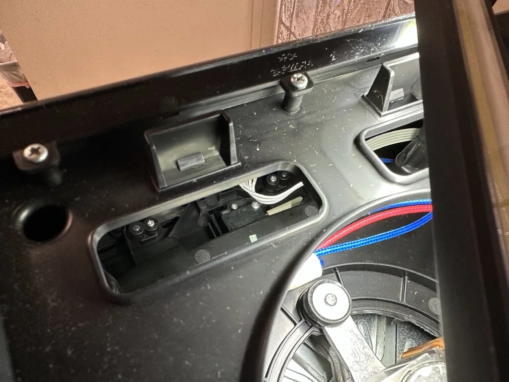

Figured I'd post pictures on how to take apart a Gourmia Air Fryer and see how repairable the unit is. Unit is showing 'door open' warning despite door being closed.

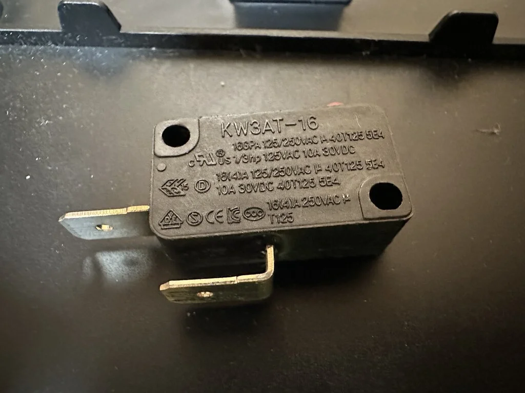

Door switch part numbers. KW3AT-16 'red switch' NO Normally Open switch.
Recommend ordering several before attempting repair.
Remove 8 recessed perimeter screws to remove the bottom cover.
No need to remove the two screws by the plug wire.
No need to remove the bottom cover to get to the top components.
Removing the bottom cover gets to the oven bulb and rotisserie motor.
Pry the top cover which is held on by five tabs to get access to the top components. Break one tab you win some you lose some.
Remove the three screws to remove the control panel.
To get access to the door switch.
