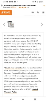

It biodegrades once mixed with gas. It's also only FB rated.
Yes biodegradable when poured on the ground.Most modern 2 strokes have a miscibility additive which keeps the oil mixed with the fuel.No need to shake the can.For those using Stihl Ultra,keep using it.I dont know of a better 2 stroke for use in the OPE industry.
