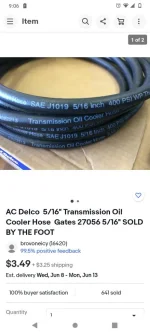

Can you mail order some line instead of driving it?
Nope. I'm out in the woods right now. Best I could do right now is maybe turn it on it's side, if the hose barbs don't hit the support bars, and zip tie it in place, temporarily. I might have enough scrap hose and a 5/16 barb union to splice in for the output up top to reach that way.
