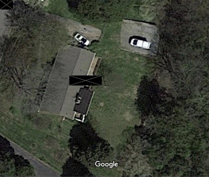

I have an area leveled and coated with crushed gravel, this was installed by the previous owner. I am wanting to use it in part but might prefer modifications.

I am thinking that I would prefer to remove the wood ties and build concrete block / CMU sides straight up, i'll obviously remove the two trees on the far side. (and the brush LOL) I have two thoughts about the chopped corner on the far side, one being to build it out, the other being to put a lean to / storage / compressor back there.
This area is 28 x 33 inside the ties to the forward portion of the chopped corner there is a bout 6 feet back to rear wall, I believe if we built walls straight up, it would accommodate 30x40.

OP, maybe it’s me but the pad doesn’t look that big. As someone with around 16 garages and one that’s 25x40, I’d say you want extra width. Make sure the doors are extra wide so it’s easy to pull anything in or out from any direction.

The pad isn't symmetrical with respect to the ties buried, the side in the foreground is shorter than the far side. It is essentially level in the area though. Also will pour concrete out the the drive way. This picture was taken from the rear deck of my house, Im thinking a man door just about where that tie ends.

How much room do you have next to the existing pad?

A little, it basically has to go here, i could enlarge the area a bit, but the driveway is directly in front of this.

Heres some additional photos. The Sat image perspective is slightly off but hopefully can help with what I'm working with.
