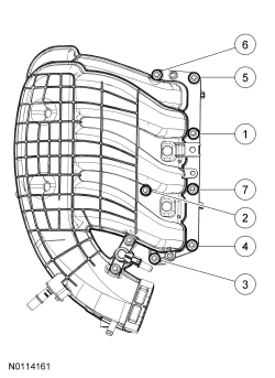

Can someone please lead me to the proper torque specs for the intake and valve covers for my 3.7 F150? Google and a recently purchased subscription from alldata is of no help. I plan on doing plugs and valve cover gaskets as soon as I can find the proper specs.
  1. Using new gaskets, install the upper intake manifold and tighten the 7 bolts in the sequence shown in 2 stages.
    • Stage 1: Tighten to 10 Nm (89 lb-in).
    • Stage 2: Tighten an additional 45 degrees.
imagen2.dll
It is an excellent excuse to invest in a 1/4" dr torque wrench that is capable of angle torque. ;)
As I recall every M6 bolt on that engine is 89 in lbs, including everything in the timing set.
I wasn't aware of the 45 degrees on the upper intake. I didn't do it and the world didn't end (shrug)
