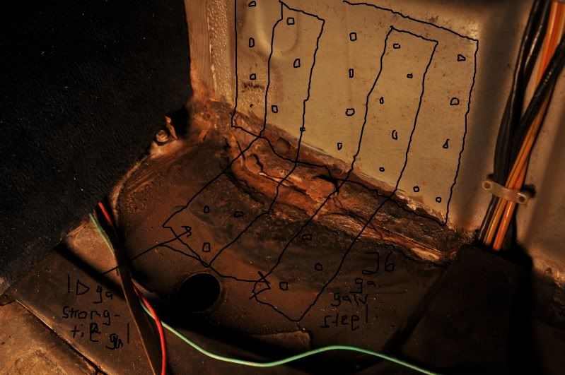

I then took the simpson strong-tie galvanized straps and formed them to be the true support between the good metal on the inner rocker and the good metal of the floorboard.
I used a few that are 18 Ga galvanized, and two in the main "hole" area which are 10 Ga or heavier. They were pre-drilled, so I am able to form them to the shape of the angle for the floorboard/rocker connection, and use the holes in them to be the guides for the holes I drill through the metal in the car.
A picture is attached:

Ive drilled all the holes for the rivets, and after everything is painted and dry, then Ill coat with tar, other rust-preventative coatings, epoxy what needs to be epoxied in place, and then rivet everything tight.
Once all riveted, I plan to repaint the whole assembly from the top, after applying brushable seam sealer.
