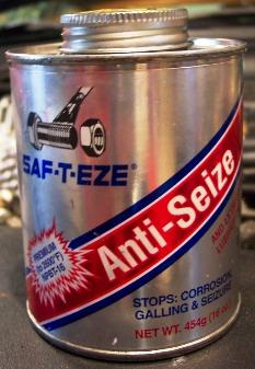

I've been using this nickel-based antisieze from McMaster:

I've used the same Champion Anti-Seize as Paulo57509 does. Had the same bottle for I don't know how many years. Hope it works well on aluminum heads like my Civic with the +4's... Cheap and effective.
