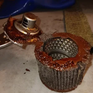

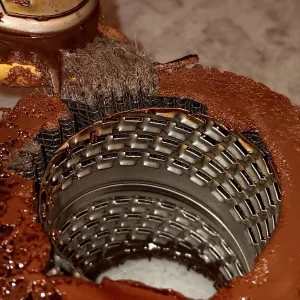

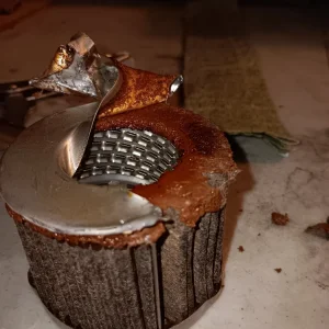

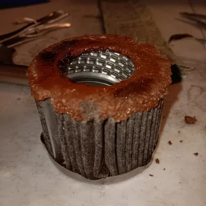

Heres a full album photos of the teardown after roughly 2 weeks of drying with paper towels. Media is very well potted with roughly 1/8" deep of chocolate brown colored plastisol. Media felt very soft on the fingers, the texture is certainly more finer than that I have seen on the previous pink Fram synthetic media. There is 2 layers followed by a metal wire backing mesh screen.

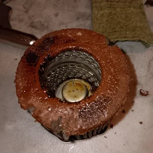

You can see the partial exposed wire backing on the defective pleat prior to ripping off the endcaps with pliers.

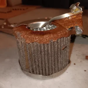

HPL appears to be doing some cleaning is this is the first time I've seen this many chunks of carbon specs on the filter.
