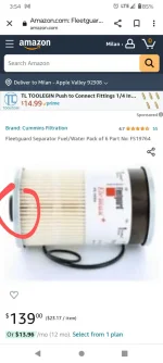

The fuel/ water separators are apparently not compatible with the additive.
The filters have a rubber like material that's a seal when installed. Those are melting and becoming blob then without that the filter it's sending who knows into the fine fuel filter and plugging those up.
Here is the filter and the part that's circled is what's melting.
Not sure what my next plan is just yet.

That would seem to be the root problem. Your additive is like trying to fix an engine that has a material or design defect with an oil.
Biobor JF is good for killing the black stuff-maybe a better filter on the fuel dispenser would help? I've used PS SIlver a lot in the past, I didn't know it could melt rubber in filters? That could be a disaster on a CR diesel...

I don’t think the Power Service is your problem. I’ve used it in my 2012 Cummins Ram at recommended and double dose rates without an issue. I use Fleetguard filters on my truck as well.
I’m guessing it’s a reaction with the algae that’s causing your problem. You need some sort of biocide to kill the algae.

Didn't have the rubber disintegrate untill I started adding the stuff. Before that it was just the occasional plugged filter.

some chemicals eat some rubbers. Natural rubber and PAO is one instance. I've used PS white and silver over the years without issue. Recently I tried to use my Topsider oil extractor. One of the flat seals had turned to slime. I hadn't used it all that much and motor oil is all it ever saw. I'm thinking they must be using a natural rubber product and the Group IV/V portion of the used oil is attacking the rubber. What are the ingredients in PS silver? What type of rubber in the fuel filters?
