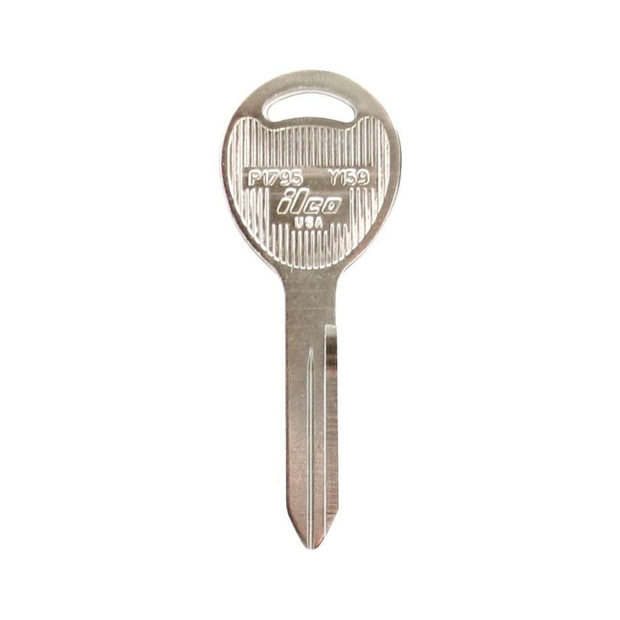

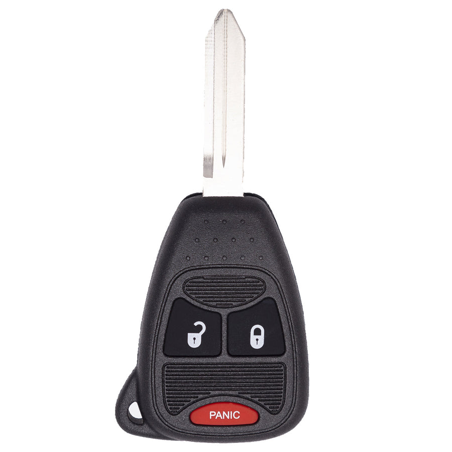

I'm often cutting doubled sided keys exactly like this.....(see image A below)
Other times Keys like Image B
I never really have a shoulder to work with, just the FOB plastic as shown here.
It's harder cutting the 2nd side because I no longer have a flat edge in the clamp.
Often, the aftermarket keys are up to 5mm longer than the OEM key.
What's worse, cheap aftermarket keys aren't always grooved exactly the same on both sides and the grooves might be off by as much as 1mm making alignment really difficult.
So I've tried just inserting the blank and the original so that the very end tip of the key aligns with the clamp. That still doesn't always result in a working key. I'm blowing through hundreds of dollars in key blanks trying to get a 90+ % success rate. I'm near 10% at the moment.

1). Insert original key into Left side clamp, using the index guide to perfectly align the end of the large groove in the key with the edge of the index on the Left side. Insert the key into the clamp so that the entire edge to be cut is out of the clamp so that the guide can follow it.
2) Insert the Blank Key to be cut into the Right side clamp. Align the key with the guide so that the end of the large groove is aligned exactly as the Original key on the Left. Adjust the depth so that it is the same (as close as humanly possible) as the key on the Left.
I would need to use a caliper or micrometer to get it any closer.
3) Adjust the follower (that determines the cut depth) so that when it is riding the highest point on the shoulder of the Left key, it is just barely touching the shoulder of the key to be cut on the right. Touching by just a hair or less.
4). Run the cutter, then repeat the process for the other side, NOT removing the original key.
5) Using a wire brush on a wheel, debur the edges of the key just enough to remove a sharp edge.
6). Try the key.....FAIL.....debur the key a bit more....FAIL....Examine key to see if it looks the exact same as the original.....FAIL. In most cases it is the 5mm from the tip that is visually different.
7). Dispose of wasted key blank.
When I use the copier, I gradually cut into the key blank. I don't just go in one pass. Think of it like a CNC and use a few passes to get to where it needs to be. Also they do use different metals in key blanks. Genuine Ford ones from Rotunda/Stratec are a softer metal and cut easier. Some of the knock off brands are a harder metal and will chatter more. Also a couple toots of Tri-Flow on the slide will make it work so much better.
Well, I tried a slightly different approach this evening.
Instead of trying to align the guides with a shoulder (which these keys do not have) I aligned them tip end to tip end.
This means that the blank key is positioned so that the cutter reached the very end (tip) of the key at the precise (or very close to) the same time the guide on the original key reaches the tip end.
This seemed to work much better.
I cut two keys and both worked. Somewhat.
One of the keys works well in the door lock and the ignition. The other works really well in the door locks but is a PITB in the ignition, requiring quite a bit of fenagling.
Still, two out of two that weren't complete failures is an improvement.
