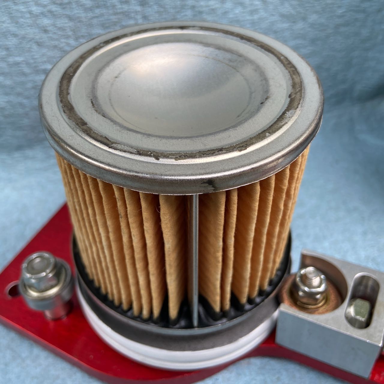

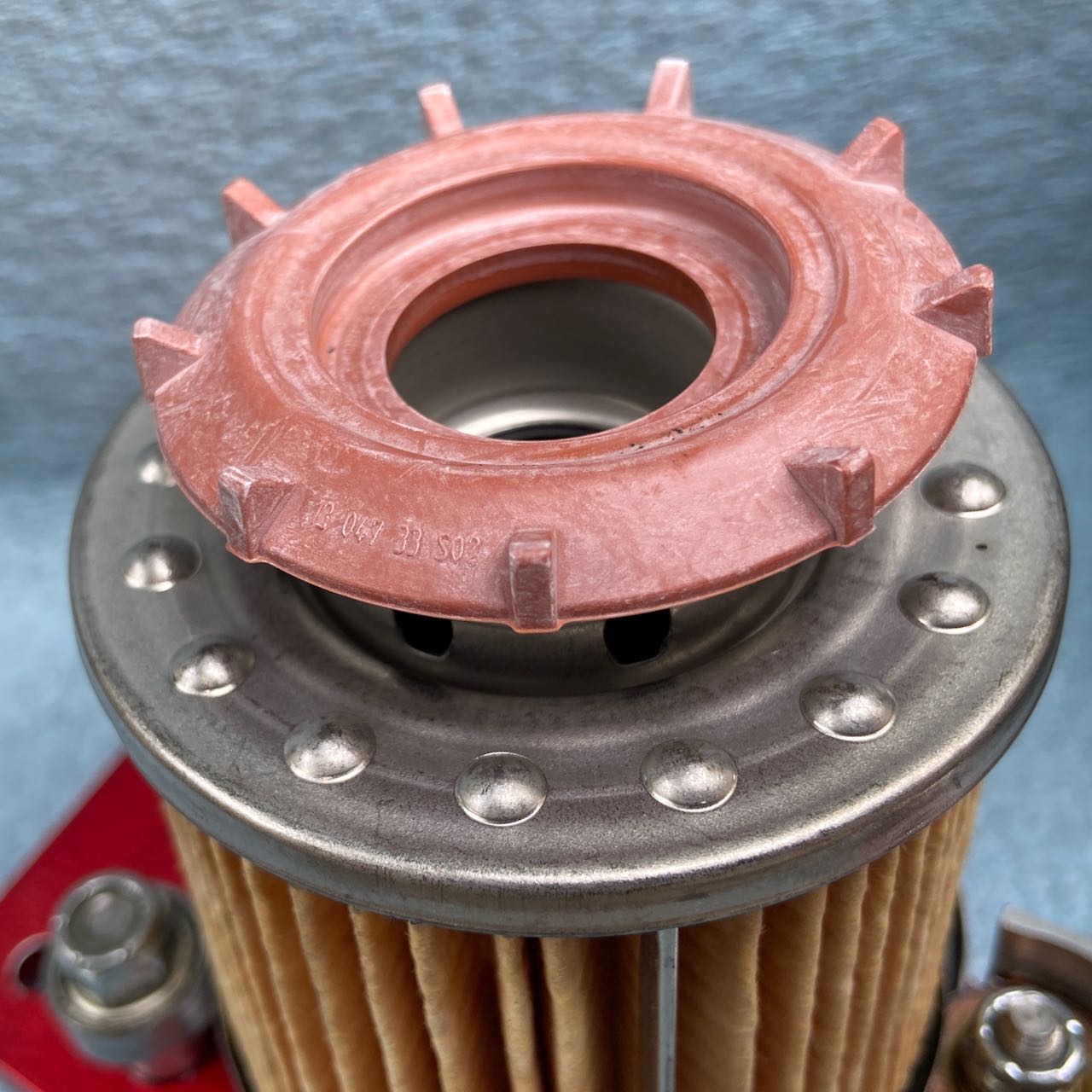

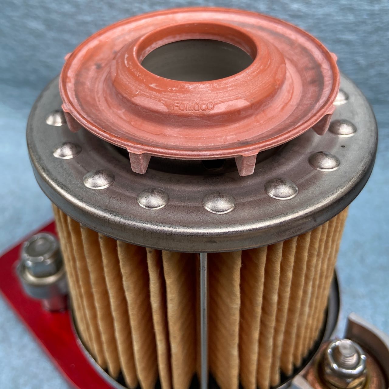

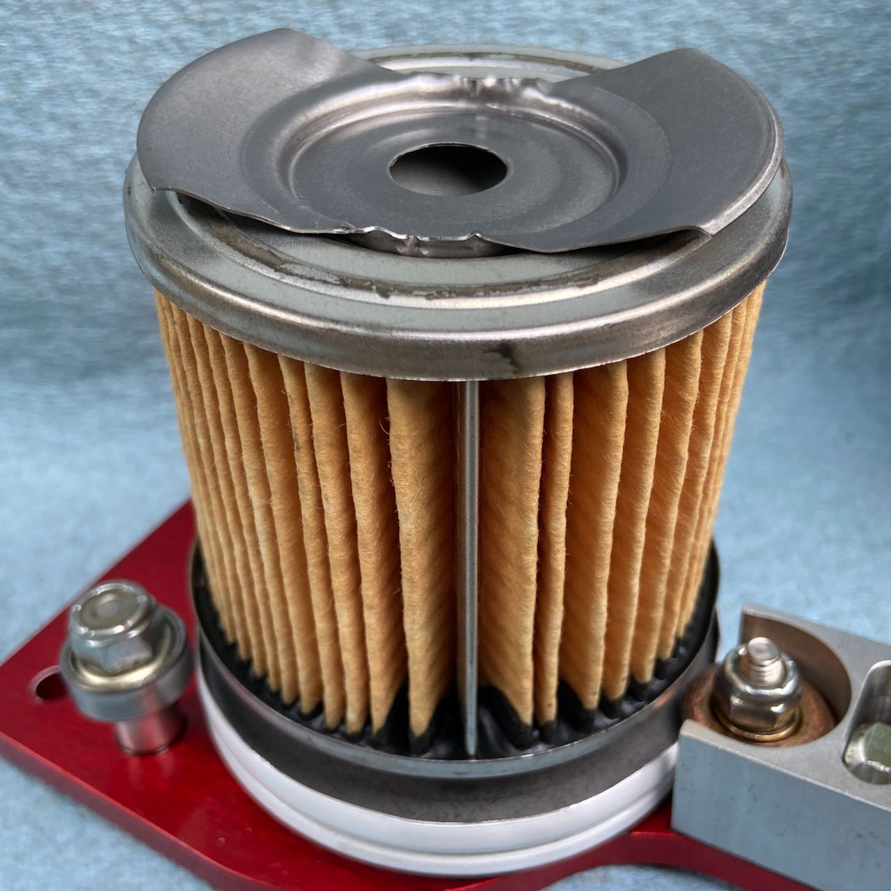

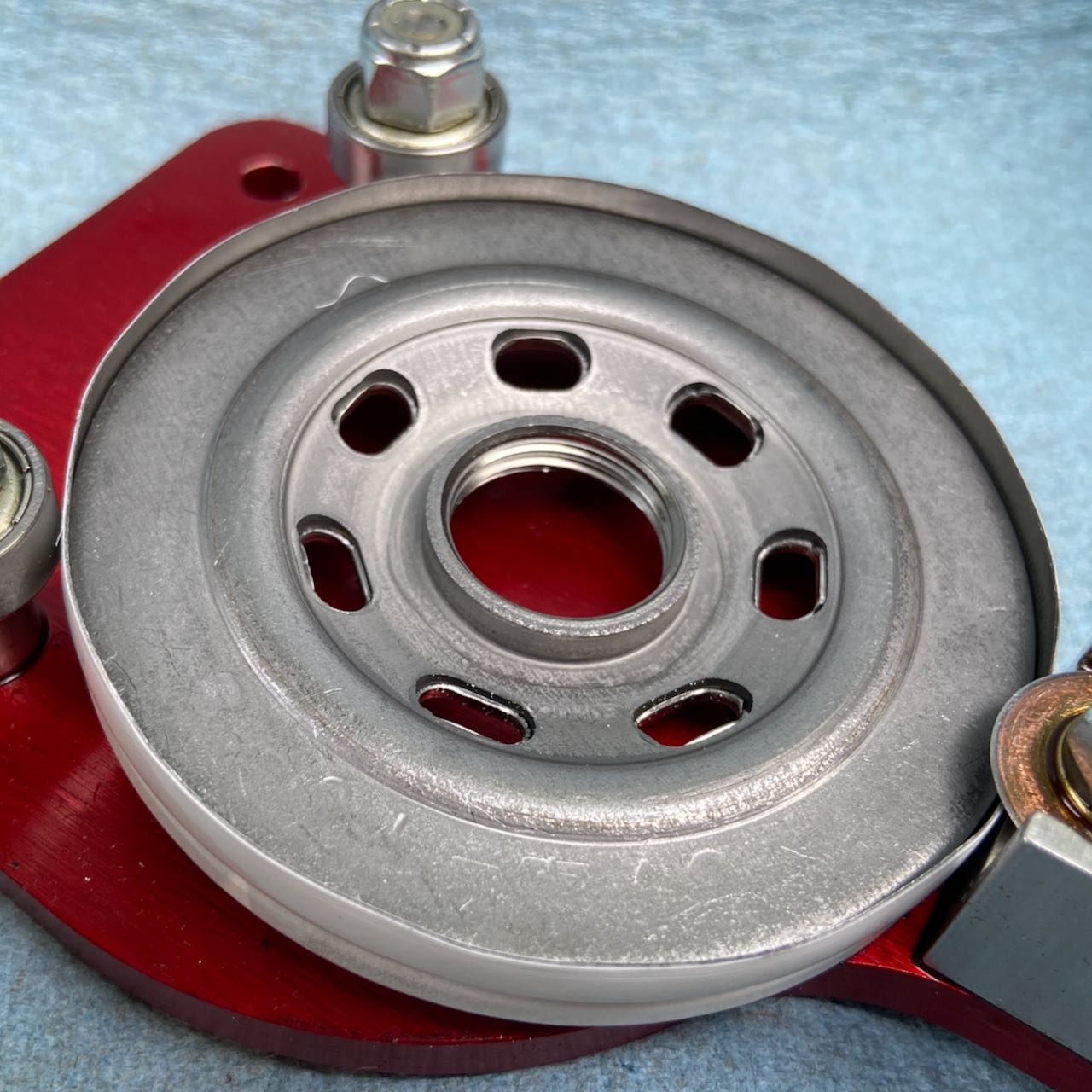

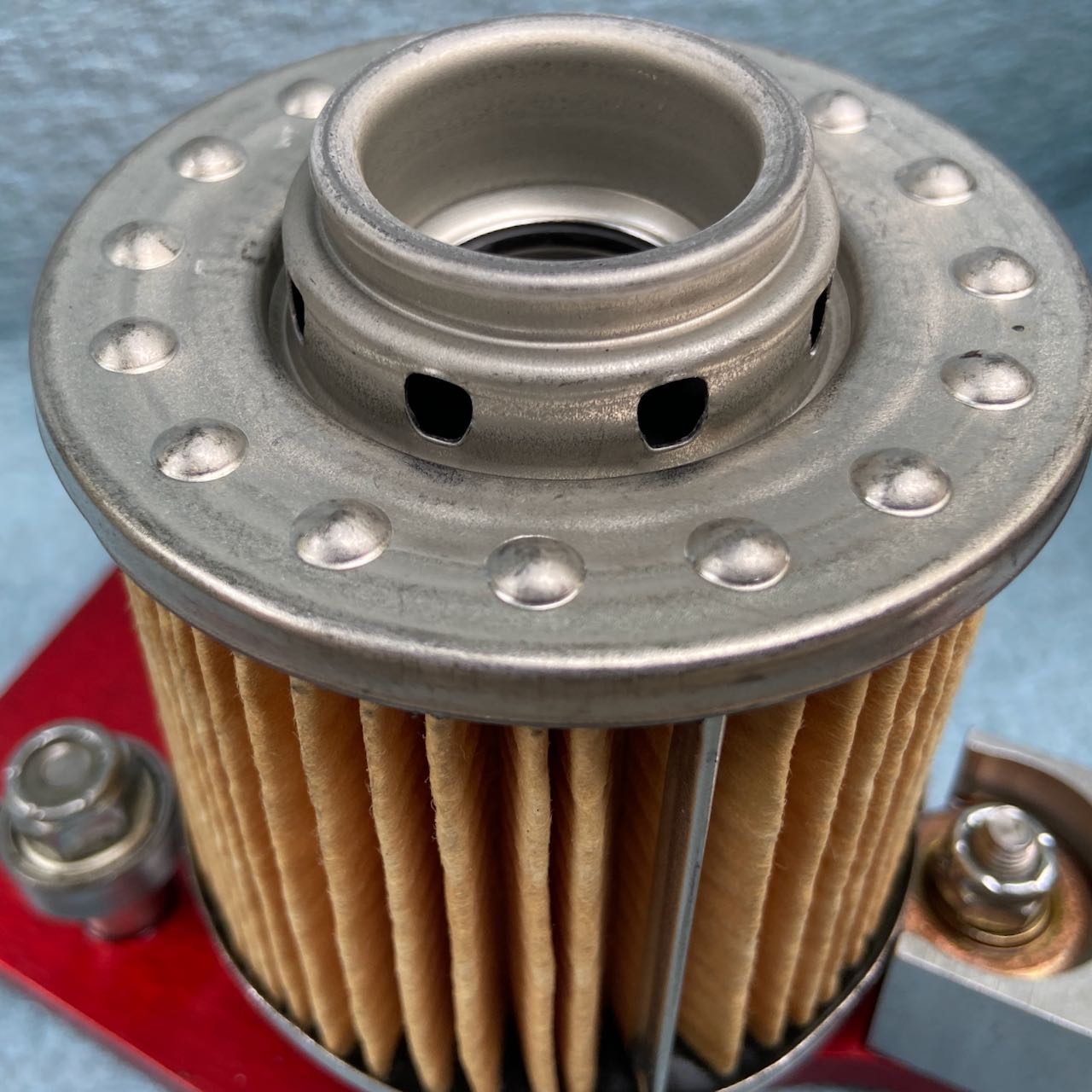

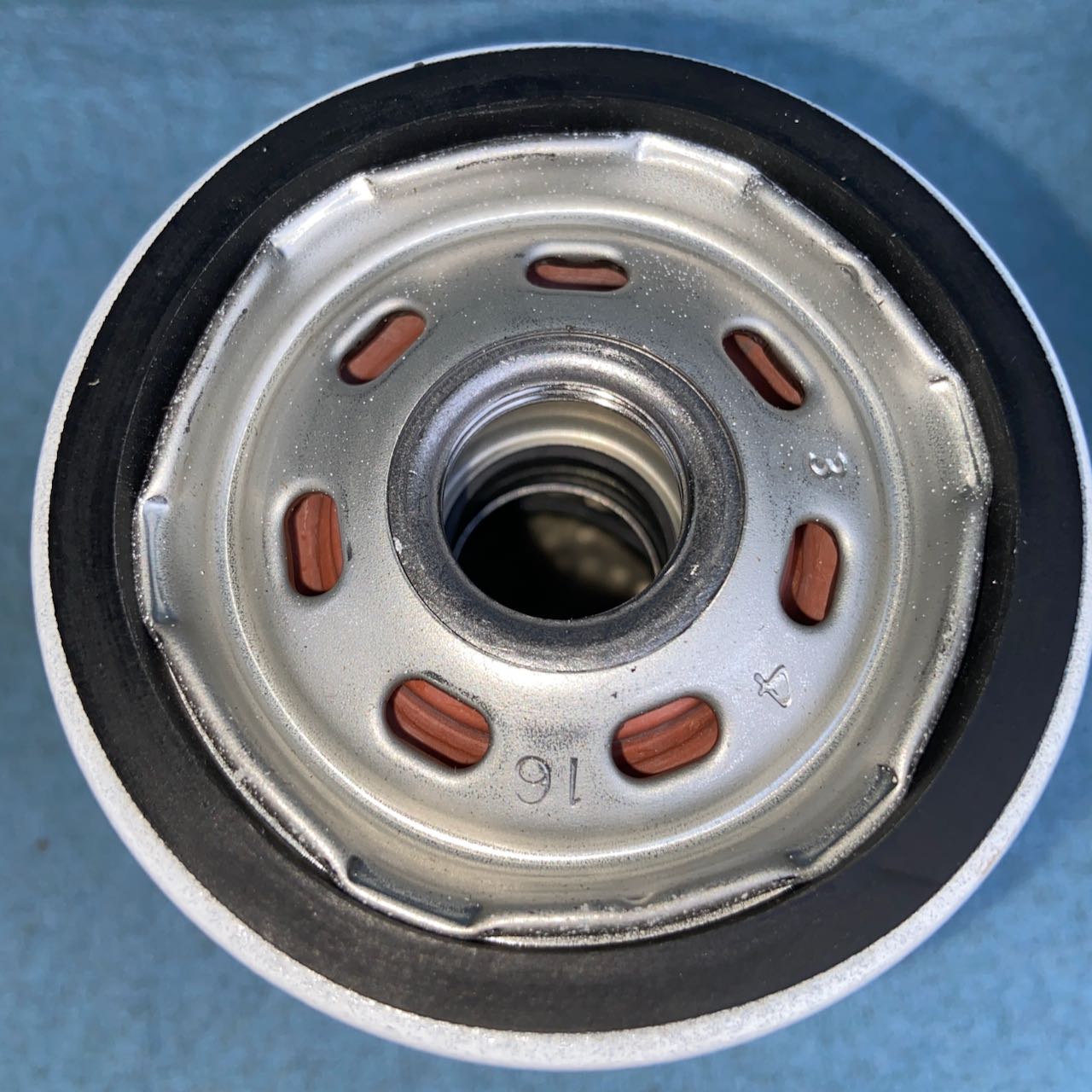

B BlueOvalFitter Joined Feb 28, 2003 Messages 11,977 Location Cajun Country, La. Jul 15, 2021 #2 Thanks for the C&P. It looks like Purolator has fixed the base inlet holes. It looks as if there are no cuts in the ADBV.
P pbm Joined Apr 19, 2004 Messages 11,011 Location New York Jul 15, 2021 #3 I like that the pleats are straight and the media seems thicker ..
D derweed Joined Jul 31, 2013 Messages 74 Location Pennsylvania Jul 15, 2021 #4 It looks like there is reinforcement at the bottom of the pleats where the tearing was occurring? Can you confirm that?
T TnT_M Joined Jun 19, 2020 Messages 3,091 Location Iowa Jul 15, 2021 #5 DuckRyder said: Click to expand... Nice filter! I use it on my Deere LT150 mower with a 15hp Kohler. Just my $0.02
ZeeOSix $100 site donor 2022 Joined Jul 22, 2010 Messages 50,052 Location PNW Jul 15, 2021 #6 derweed said: It looks like there is reinforcement at the bottom of the pleats where the tearing was occurring? Can you confirm that? Click to expand... Just potting material (glue).
oldhp Joined Jun 28, 2012 Messages 3,873 Location Southern Illinois Jul 15, 2021 #7 Better spacing on pleats. Has there always been a metal crimp?
DuckRyder Thread starter Joined Oct 20, 2005 Messages 10,322 Location Scruffy City Jul 16, 2021 #8 BlueOvalFitter said: Thanks for the C&P. It looks like Purolator has fixed the base inlet holes. It looks as if there are no cuts in the ADBV. Click to expand... You're welcome. There were no cuts. pbm said: I like that the pleats are straight and the media seems thicker .. Click to expand... Thats true, the spacing is still wonky though, derweed said: It looks like there is reinforcement at the bottom of the pleats where the tearing was occurring? Can you confirm that? Click to expand... I think what you are seeing is potting material. It does appear to go up higher than typical but whether that is intentional or not is anyones guess. tnt_motorsports said: Nice filter! I use it on my Deere LT150 mower with a 15hp Kohler. Just my $0.02 Click to expand... Decent for 4 bucks for sure. oldhp said: Better spacing on pleats. Has there always been a metal crimp? Click to expand... Not sure about the metal crimp this is the first one I've cut open. It is a short FL400S and the 400S does not have a metal crimp, at least so far.
T tig1 Joined Jan 3, 2009 Messages 15,318 Location Illinois Jul 16, 2021 #9 derweed said: It looks like there is reinforcement at the bottom of the pleats where the tearing was occurring? Can you confirm that? Click to expand... I have been using the 910s for many years and have never seen the paper with a tear.
T tig1 Joined Jan 3, 2009 Messages 15,318 Location Illinois Jul 16, 2021 #10 oldhp said: Better spacing on pleats. Has there always been a metal crimp? Click to expand... yes
