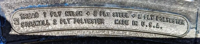

I can't find a ply rating for these, does anybody know what it is? The AT3's are easy to find but the plain Discoverer A/T isn't.
Cooper Discoverer A/T All-Season 235/75R15 105T
CLICK
First, this is a P type tire and they don't come in "Ply Ratings" (PR). They come in Standard Load (SL) and Extra Load (XL) - and that one is an SL. Besides, they don't use PR anymore, they use Load Range (LR) (C, D, E, etc.)
I am hoping you don't mean how many plies they have - because pretty much all P type and LT type tires come in a 2+2 configuration = 2 polyester plus 2 steel - and maybe a couple of nylon cap plies. In this case, my best guess is that it has no nylon cap plies.
And just for reference, this line of tires is a WalMart only line and WalMart does a terrible job with tires on their website. Even Cooper's own website doesn't acknowledge these - and that is pretty common for WalMart. Tire dealers strongly object to selling the same tire as WalMart, because WalMart benefits from the sheer volume of tires they purchase - and since they offer very little expertise during the buying process, you need to either know your year/make/model or have to kind of know what your looking for.
