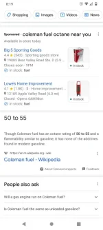

Nope. Octane is too low. Most engines call for 89 octane. Coleman fuel is 50-55 plus there are no detergents in it.
