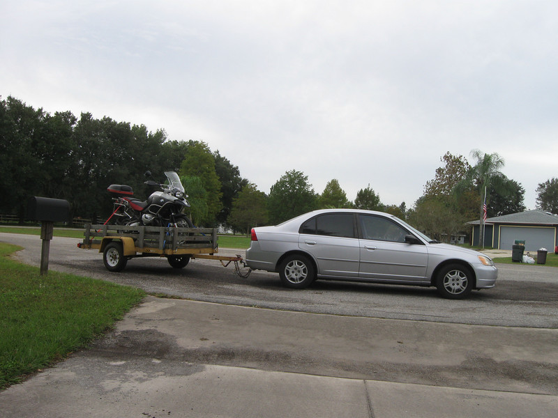

Get one with a stick. Ours gets used and abused as our hauling vehicle, 166000 miles without any problems and still on the original clutch.
