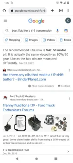

Guess you never owned a Honda with a manual? My 87 f250 takes sae 50 motor oil in it's manual transmission. I went with 40 because 50 was too hard to find.
I never knew Ford called for 50wt in any of their transmissions. All the old 4 speeds I’ve messed with (assuming that’s what you have) have always had 90wt in them. I’d say the drive ability is a litter better with 50wt.
