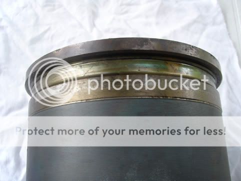

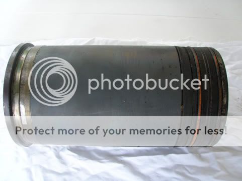

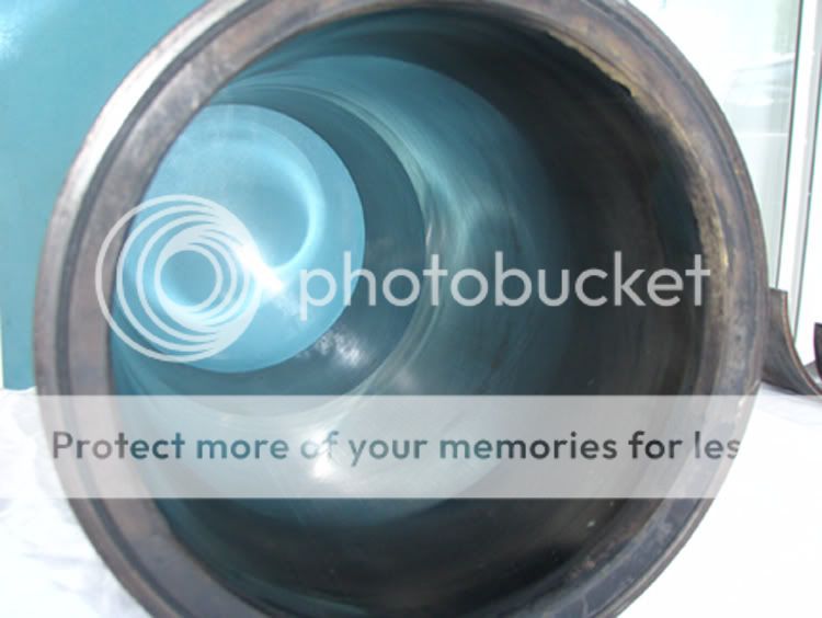

Doug, are the above photos your Delvac 1 runs?
Quote:
This particular engine of mine (DD Series 60 - 500hp) was dismantled by Detroit Diesel Allison-MTU (manufacturer) in Brisbane, Australia at 1.12m kms.
Near 700,000 miles and the photos are all titled with Delvac. I don't know OCI/filter protocol.

If these are the runs he's posted about before, they were extended OCI's.

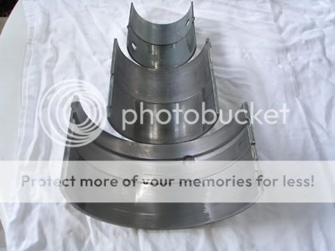

Do you have a picture of the thrust bearing or do these big diesels run a different type of setup?

Pablo - Firstly, thank you for posting the pictures for me - I appreciate that a lot
Information:
Operation = Interstate, Linehaul,Reefer - one Driver for life,
Typical use per annum = 225kkms
Detroit Diesel 12.7ltr Series 60 @ 500hp, 1650lb/ft @1200-1525rpm
Cruise revs 1650rpm, Max revs 1800
Donaldson ELF Filters + MannHummel Centrifuge
Lubricant = Delvac 1 5W-40 (from 60kkms)
OCIs
Average = 99711kms
Longest = 116227kms
Data
Soot
Average @ OCI = 3.2%
Highest @ OCI = 7.8%
Iron
Average @ OCI = 134ppm
Highest @ OCI 221ppm
Highest TAN @ OCI = 6.13
Lowest TBN @ OCI = 2.26
Centrifuge uptake rate = 0.0029g/km
Oil consumption averaged almost exactly 6kkms/ltr
The two major condemnation points were soot (3.5%) @ iron (150ppm) - viscosity was always near new
I hope this is of interest

BuickGN - Sorry I have no pictures of the thrusts. This area is "bullet proof" and where possible the bearings were simply "turned" - including the camshaft bearings
These engines have a very robust bottom end!

Doug, the main and rod bearings appear to be worn out. Did they still measure in spec, after 700,000 miles? Did lead, tin or copper in the UOA foretell the condition of the bearings?
Hi,
SudLGT - Worn out? They measured within specification and are still in the engine. As mentioend earlier where possible it is common place to "roll" them - this was done of course
Wear metals on this engine as requested:
Average at OC in ppm;
Copper 7 (30) Max recorded 63
Lead 43 (30) Max recorded 68
The bracketed figures are the condemnation limits from DD-MTU
Roll = changing the position of the bearing shell from top to bottom

Very interesting, I've never heard of rolling the bearings. Then again, I've never had any bearings that were "rollable". Some were really bad and some were just bad. Before I went to a heavier oil I tried some of Clevite's "race" hardness bearings and ended up costing me a crank too. In the end, regular hardness bearings and 20-50 solved my problems.
