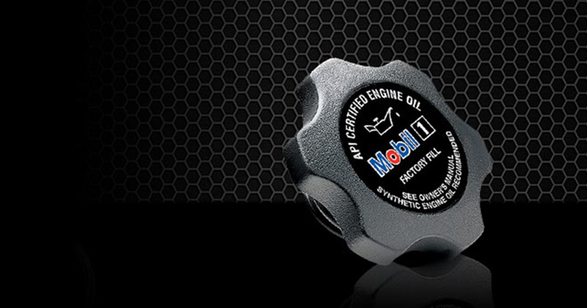

Late to the party here. Pennzoil Platinum Euro 5W-40 isn’t really that much more special when compared to their counterparts from Mobil or Castrol. They are all great oil and the decision to use one over another is highly subjective. As to why Ferrari uses Pennzoil here in the States, that’s only because Ferrari SpA has a long history of using whatever oil their F1 team is associated with at the moment. Currently, that company is Shell, which is the mother company of both Pennzoil and Quaker State. Before Shell decided to market Pennzoil, they were marketing Quaker State as the oil of choice for Ferrari back in 2007. Personally, I prefer Mobil 1 and have been using them in all our vehicles, including my Ferrari since the early 2000’s when Mobil 1 0W-40 came out. Before that, it was Agip, simply because that’s the company that the F1 team was associated with back in the days.
