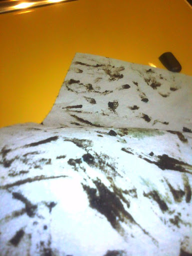

Just checked oil level after sitting for night, will add some. And took a closer look. Someone took off valve cover before, I can see liquid gasket sticking out in some places. Question will it easily come off? And should I use liquid one again or just order one from internet. There is confusion to me again, which side is front part of engine? Left or Right? As I remember--left. Also will need to remove coolant hose from radiator, it goes right above left part of valve cover. Don"t really want to mess with coolant spills,in my parents garage.

The screwdriver picture tells a story in itself.
I would stop using cheapo mineral oil. Don't want to add to the sludge. As you burn oil, top it off regularly until you run out of your Supertech or whatever. Start buying synthetics from this point on even if it contradicts the ARX directions.
I would definitely cut open every filter during that ARX run, especially if bore-scope inspection or valve cover removal is too difficult. It would be good to see what is going on and filter contents might give a clue.
I would NOT run ANY other additives until you inspect your engine.

That's what I got out thru those 2 little holes.
A lot of little chunks of sludge,that I scraper out from hole underneath PCV. Very sticky and feels like there is a sand inside.

Sounds like your engine is not as far gone as the one I worked on, based on the single puff of smoke at start up. This guy had neglected his oil changes while using regular oil and even admitted "missing a few oil changes" along the way. The stopped up drain holes in the rear bank were just too far gone for any chemical to clean them out alone, based on how hard it was to clean them out manually....it was like chipping through solid rock!
If I were in your shoes, I would use that "screw driver test" to find the best chemical to fix this problem using actual experiments. For example, suppose you have been told that Kreen is the best for this situation.
Mix small amount of Kreen and oil in the correct proportion, warm it up, put the solution in a clear container and dip your messy screwdriver in it. Give it some time.
If the following two conditions are met, you have found your solution:-
1) Screw driver becomes squeaky clean
2) Importantly, the solution has no solids floating in it i.e. it liquefies all the sludge rather than breaking it up.
As long as you have the steady supply of the "messy screwdriver", you can try this with different elixirs such as MMO or zMax.
