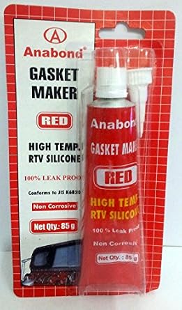

And as I can read here...it is also double "win-win" since esters also help to swell/recondition old gaskets... Feel free to correct me if I am wrong in my asumptions/acts smile
Esters only help to condition seals.
Sure. When discussing seals such as in engines, transmissions, and other driveline components, the context is that of using flexible, elastomeric materials to keep fluids contained within the mechanical system that has rotating components exiting the system, such as protruding rotating shafts. For a gasket, the context is that of using a material (such as the silicone material you showed) or cork, or some other material to keep fluids contained in and around stationary objects, such as the valve cover gasket on an engine or the pan gasket on an automatic transmission. Both seals and gaskets "prevent" loss of fluids.
Most ATF seal swell agents today are composed of esters: tris (C8-C24 hydrocarbyl) phosphite ester Bis(2-ethylhexyl) ester phosphoric acid Dihexyl Phthalate ester and the azelamides such as: N,N'-dimethyl-N,N'-dihexylazelamide, N,N'-dimethyl-N,N'-di2-ethylhexylazelamide, N,N'-dimethyl-N,N'-di-2-ethylhexylsebacamide
