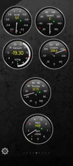

2001 Grand Prix with a 3.1-liter motor, started idling high after good and warmed up. No codes at the time. When motor would idle too high, 4T65E trans would shift super late under light throttle. About 25 MPH and 2,500 RPM before it would hit 2nd. gear. Was OK the next day.
3rd. day, high idle and late shift again!
This time the check engine light did come on. Code P0121. Scanner TPS angle percentage at idle shows 0 sometimes, and sometimes 0.39% and ~ 100% at WOT. One time while sitting there idling fine, ~ 700 RPM, all at once the idle kicked up to ~1,300 RPM all by itself. I looked at the scanner, now TPS angle percentage went up to 2.75%.

Still having Issues! Already replaced TPS.

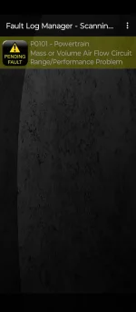

SOS if not worse, now with a Pending P0101 code.

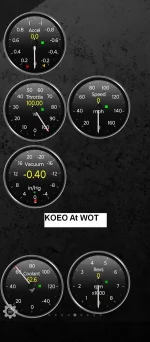

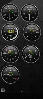

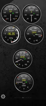

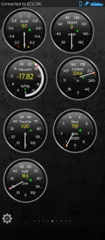

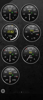

Can anyone of you all look at these screen shots from Torque Pro and see if you all can make any sense of any of them?
RPM TPS% Temp and MAF are shown. All RPM readings are with accelerator pedal at rest.
KOEO with accelerator pedal at rest TPS % Is 0%.
KOEO with accelerator pedal at WOT TPS % Is 100%

if you are getting varying TPS readings and you aren't touching the throttle pedal,it sounds like you are on the right track.
you wanna talk about an electronic part that is subject to wear, the TPS is one of those,
if you are getting varying TPS readings and you aren't touching the throttle pedal, it sounds like you are on the right track.
Right! Thats what I thought too! Because I got the 2.75 % throttle % reading when the idle kicked up to ~1300 RPM without me touching the throttle pedal.
However, with KOEO with accelerator pedal at rest TPS % Is 0%.
And KOEO with accelerator pedal at WOT TPS % Is 100%.
This is what gets me.
Plus, now I have the pending DTC P0101?
I did clean the MAF sensor yesterday but didn't reinstall it yet, but TBH I don't think that's the answer.
unless you have a scantool with a graphing function it is going to be difficult to read any sensor that is within range but has an erratic signal . a voltage signal by itself is too static to see the changes... so a TPS is cheap, try replacing it.
unless you have a scantool with a graphing function it is going to be difficult to read any sensor that is within range but has an erratic signal. a voltage signal by itself is too static to see the changes... so a TPS is cheap, try replacing it.
