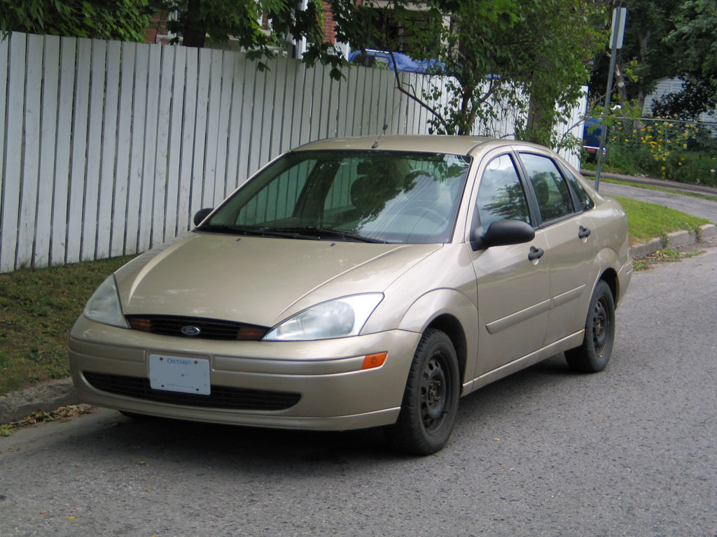

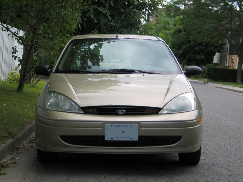

I've spent a whopping $145 on getting the car ready to be road legal thus far and have been driving it around this afternoon and it's a lot of fun!
Here are some pics:
