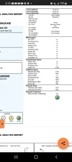

Looks like another solid oil from Amsoil. Great additive pack.

Good chunk of moly!
Is it the traditional moly or the trinuclear type? which requires less but is as "effective" based on what I've read ... I see max of 80 with trinuclear if I'm not mistaken.
Does anyone know?

Lots of metallic additives. There is no way this stuff will meet the sulphated ash limits for Dexos.

I noticed that on the upper left of the screen shot, it states new oil. Please correct if wrong, just going by what I can see. I have been testing a few different types:.........signature series, OE, and Napa is the last one tested. Per the Amsoil website, signature series should have a TBN of 12.5, once I can redact my personal info, I will post my tests showing Signature, OE and Napa. Is this test new oil? If not, how many miles at this sample?

It was fresh out of the bottle.
Amsoil looks like they are taking the API gloves off and making sure their additive package constitutes a TBN of 12.5 compared to when they first moved away from heavy calcium to combination of calcium-magnesium….which seemed to produce a lower TBN compared to specification sheets on website…. Prefer a company like Amsoil to go above and beyond requirements and focus on engine protection for extended drain intervals… would feel more confident doing an extended drain with this oil and additive package.

Metallic additives are not the only answer to additizing (is that word?) an oil. Some other oils may appear "weaker" in a VOA but you are not seeing its entire composition.

I know you are correct on many different levels and as oil has evolved since the start of bitog-it has been more difficult to make value judgments based on virgin oil analysis. I also know TBN retention is more important than the actual starting number…
with all that said-I do look at the metallic additives and often times correlate them with having a more stout package… in the case of Amsoil-when they had tons of calcium the total base number most always matched their specification sheet usually around 12…
When Amsoil went with the newer calcium-usually around 1200-1300 and magnesium-around 700…. It seemed like every TBN was about 9 on the virgin oil analysis… I did equate that with the reduction of metallic additives…. Now in this newest virgin oil analysis-the metallic additives are notably higher like 1500-calcium to 1000 magnesium… and the base number matched the higher one on the product data…. This led me to think that Amsoil increases the metallic additive package to insure the higher starting TBN…
I agree with your point earlier that the api limits of sulphur would be exceeded-which for me is the reason Amsoil/Redline exist-Redline basically has looked similar since the beginning of bitog…. High calcium moly zzdp… Amsoil changes their metallic addictive package and the latest one probably matched other oils more closely than in the past… they seemed to initially make it a little highe-but this latest one seems like they just went back to their roots and said let’s not try to make it close to limits-let’s go over to make sure extended drains are priority…
I wrote this because also noticed with the newer formulation and relatively lower starting TBN-used oil analysis of under ten thousand were showing very low TBN that suggested could not have gone much further…. Sorry to ramble because ultimately know that my lack of chemical acumen hinders my ability to truly understand formulations especially those that look weaker on paper-like the latest one done on here with Mobil - ep and ep high mileage that have a starting TBN under 7…. Can’t see how could last that long…

Without opening a can of worms, I'll just say that Amsoil's formulation approach differs from most of the major blenders who are advertising a similarly long drain guarantee. And different is not always "better."
