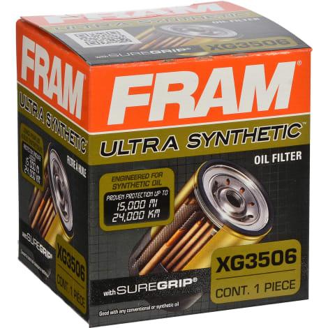

I've got some 10+ year old fram og ultra filters which I'll use soon, I cut one open and it looked great
