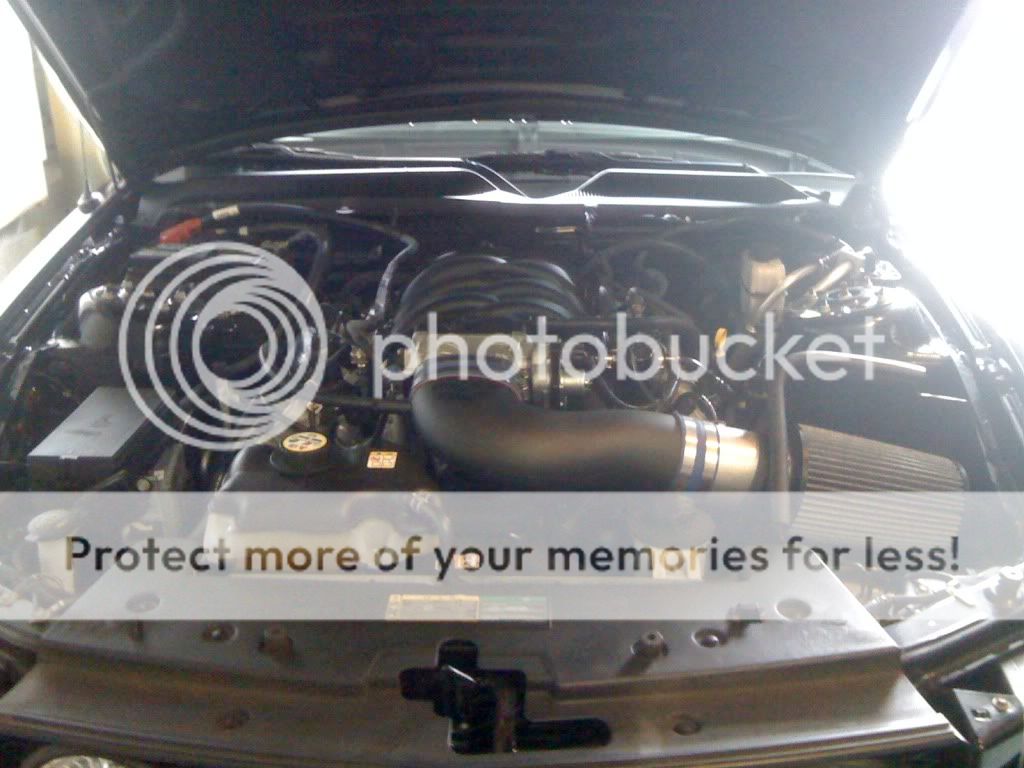

The intake breathes from under the hood, it's just a larger 95mm MAF and pipe and I threw on an AEM dryflow filter.
This is how the intake sits:

Was wondering if it had a divider to stop it from breathing the engine bay air. Your picture confirms that it does. Who is doing your re-tune?
