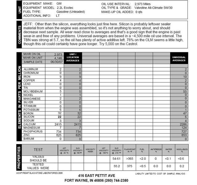

Here are the results of my first UOA on my 2007 HHR with a Ecotec 2.2 powerplant (automatic)
Ran Factory Fill in it to about 1100 miles and then changed out to the Valvoline 5W30 All Climate and ran that to just under 3K miles. Filter used was a Supertech 9018. GM's OLM said 78% remaining when I did the change.
Silicone is high as they mentioned..does the explanation they gave make sense? Should I be concerned at all about the nickel or the Maganese?
Little amazed that the sodium reading was so low especially as it has been reported that Mobil 5000 is the FF. Castrol 5W30 GTX is in the sump now...debating whether to do another change in 3K miles and make the change to Pennz Plat
Comments good or bad? I'm not familiar at all with the Ecotec or it's tendencies

You got a large overdose of calcium, phos and zinc in that Valvoline conventional you purchased. Your numbers are eerily similar to Synpower.
Good or bad??
Goose
Certainly not bad -- but a better description would be "lucky". Most-all times, that calcium number would be 17-19 -- phos would be in the 6s -- zinc in the 5s

Any concerns on the Nickel or Maganese?
Goose
Wrong guy to ask Goose! I am strictly a backyard numbers reader -- not a units # interpreter - like some of the gurus here. Blackstone never mentioned either - that's a positive sign you're good-to-go.
wear read at less than 10ppm. If anything, break in wear, especially silicon. looks good to my untrained eye. plan on using the olm?

That is one strong TBN if i've seen one for almost 3000 miles
You know, I was thinking the same thing...that TBN is pretty high for 3000 miles...I gotta say that the Valvoline AC did impress me!
Goose
BlueGoose, I think this run of Valvoline did great in your HHR. I'm anxious to see how the Castrol will compare. I think the 5w30 is the correct vis. for this motor after seeing the report comparing the two 20w samples. Both those samples had 8 and 10 ppm of bearing lead in them where as your sample had 0. Even at the 8-8700 mile marks of the other two oils it shouldn't raise pb to 8-10ppm if the oil is performing like your 30w did. You sure look like your on the right track to me.
