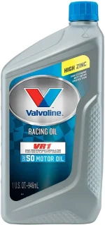

Air-cooled vehicle with short (1000 miles or less, takes a year) oil change intervals. Used for spirited driving every time it's on the road. Never driven below 50F/10C.
Between the following two options, which one would you go with and why, if price isn't a concern?
Currently got some RedLine 50WT on hand, but after these couple gallons are gone - the choice lies between these two. If there are definite benefits to using RedLine, then buying more isn't a problem. But if it doesn't edge out VR1 in any way, then 60%+ savings are definitely welcomed.
There's also Pennzoil GT 25W50 (which used to be really cheap) and M1 0W50 (which is uber expensive), but they're not mono grades which looks like what you want(y)
Pricewise for the money, VR1 is probably the way to go. I know it's a highly respected oil.

Any of those two would be fine. I'd get vr1 if i was forced between the two but I still wouldn't go for it first thing.
