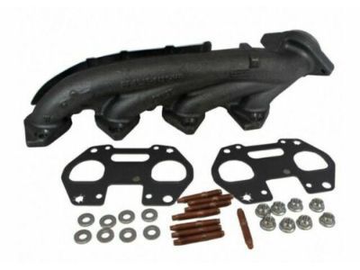

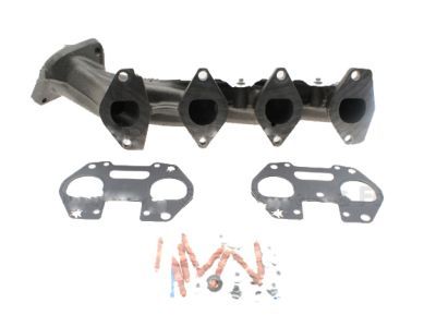

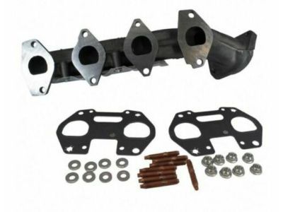

These are the manifolds I am searching for. I would love to find the OEM kit.
7C3Z-9431-B driver/ left 2006 f350 exhaust manifold 5.4 v8 . This part is readily available
Ford 3L3Z-9430-DA Exhaust Manifold Assembly 2004-2007 Ford 3L3Z9430DA passenger/ right- THIS PART IS DISCOUNTINUED

Ford 9L3Z-9K494-A​
Manifold And Gaskets Kit
2009-2014 Ford 9L3Z9K494A
Ford 9L3Z-9K494-A Manifold And Gaskets Kit
