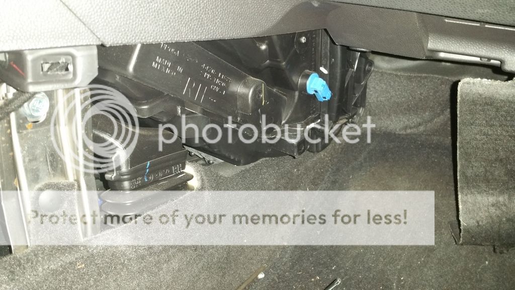

CAF is located on the passenger's side in the EVAP housing. To access this, remove the leftmost kickpanel that is attached by a single plastic screw.
Remove the blue connector, and to the right are 6 T20 torx securing the filter housing. A stubby screwdriver and or 1/4" ratchet are your best friend because it is compact. You can remove the small vent piece if you wish, it snaps right back in. Rip the old filter out and see how gross it is.

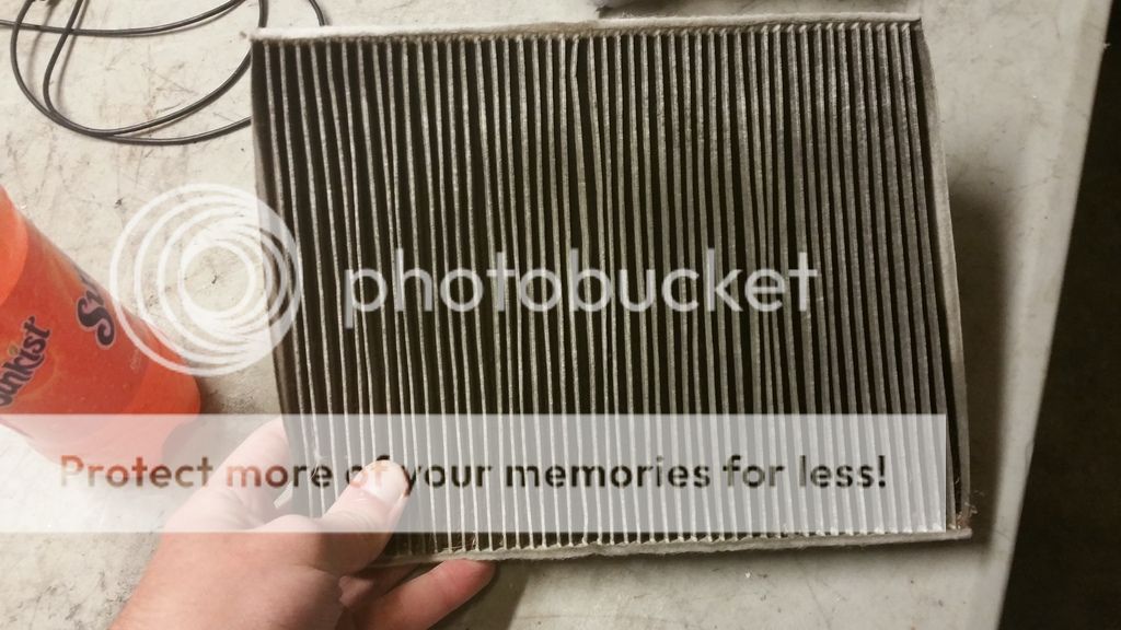

Safe to say I was due for a replacement. Pretty nasty.
