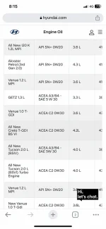

interesting thing is that this hyundai in other countries manuals says to use 0w20, 5w20, 5w30, 10w30 and 0w40, all depending on temps car will be in. In usa they want you to use 0w20.

interesting thing is that this hyundai in other countries manuals says to use 0w20, 5w20, 5w30, 10w30 and 0w40, all depending on temps car will be in. In usa they want you to use 0w20, i call bs on this.
Nope they are right . If the Manufacturer of a vehicle calls for 0w20 in all climates then that’s what we are supposed to use . Who are we to over thinking what the Manufacturers recommended. WHO ? 🫥🫥😎
