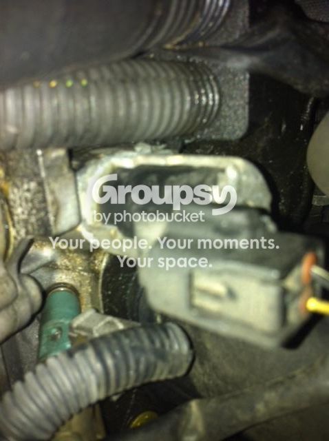

Ok took a few pics of the intake. I am a little concerned, seems a little moist back there. I am
Going to try and post some pics.
Here are some pics, yes I know there not that good, but I did what I could. All of these are where the intake manifold is. Let me know your thoughts.
Thanks
I don't think missing the oil filler would cause that, the filler hole is close to the front of the valve cover on a slope. But its possible. Take the plastic cosmetic cover off the valve cover for a better look. Removal is the 2 nuts in front, sits on 2 studs in the back that are not fastened. Just pull, it will pop off the studs. I don't see any pink crystals which would be present with Toyota LLC Red coolant loss, so I think its just a weeping valve cover, or perhaps the OCV gasket. I clean my engine every couple of years at a car wash spray booth. Allows me so see anything dramatic beyond weeps.
