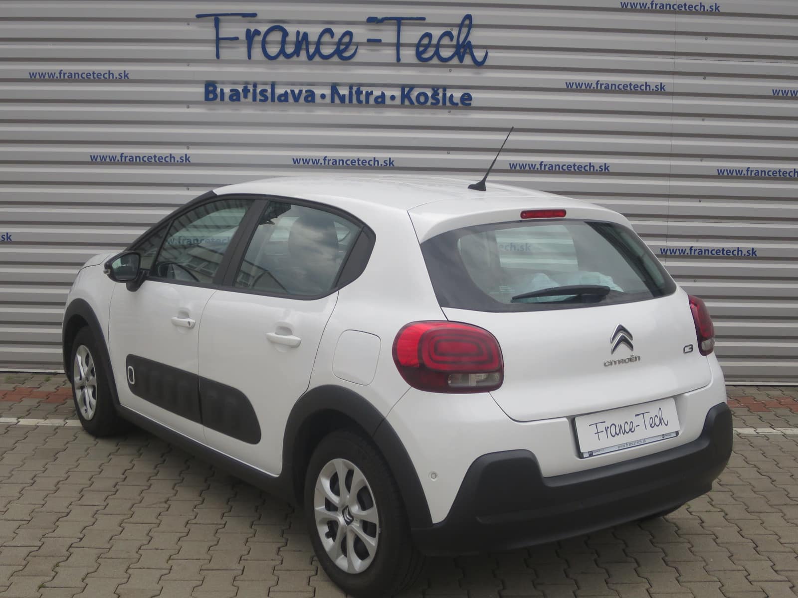

what are the differences? does it make sense for small hatchback?
or better be avoided ?
(when looking at lower profiles, xl becomes more common) i don´t understand why.
generally, when the profile gets lower the load capacity of the tyre is lower aswel. By offering xl versions more cars can fit low profile tyres in the correct width and overall diameter. But the inflation pressure needs to be set higher than on the sticker in the vehicle to get the higher load rating.
There's no difference I've ever noticed between xl and sl, for identical size and model tyres as far as comfort and drive goes. But there will be if you take advantage of the higher load capacity by increasing inflation pressure. Of course, since they are generally low profile tyres, comfort is already compromised in favour of handling.

The vast majority of tire choice in that size is XL (LI 93) with the Pirelli Cinturato P7 summer
tire (Euro spec, not NA spec AS) in 205/50 R17 89V being one of the few exceptions. That
said I would expect very little gain in going from 205/55 R16 to 205/50 R17 particularly as
tire choice is quite limited compared to the very common 205/55 R16.
Honestly, you'll hardly ever make a good handling car out of your Citroen C3. At least it's
quite comfortable for such a small car.
If you actually want to improve handling I'd do a search for DS3 Racing components fitting
your C3. See what I said about front camber above.
If your stock size is 205/55 R16 (91) I wouldn't even bother with XL/94 tyres, but just fit a set
of Michelin Pilot Sport PS4 instead. These are sitting on the front axle of my Porsche and are
MUCH better handling than a vanilla Eco/Touring tire that's likely fitted from factory. Michelin
even make a 94Y version of it if you feel better with going for an XL tire.
Start from there - with an appropriate tire.
