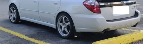

Thanks for the replies everyone. Bad alignment certainly makes sense, putting extra stress on the very edge of the tread. From the other pictures I've seen from him, the car certainly doesn't appear to have any sort of extreme camber, but apparently it could have been off enough to cause issues.

Tires weren't underinflated. they weren't stretched, they were 245's on 8.5" wide wheels. they were 245/40R18 97W.

My experience says that any camber over 1° may lead to wear issues like yours - unless the toe is exactly on spec - which they hardly ever are.
So have the alignment tech dial out as much camber as he can. This may prove difficult as many alignment techs seem to think that if the vehicle manufacturer didn't provide adjustability into the suspension, that it either shouldn't or can't be done. This is far from the truth! You have to ask UPFRONT! It may take a camber plate or an eccentric bolt (Extra cost!!), but it can and should be done!
