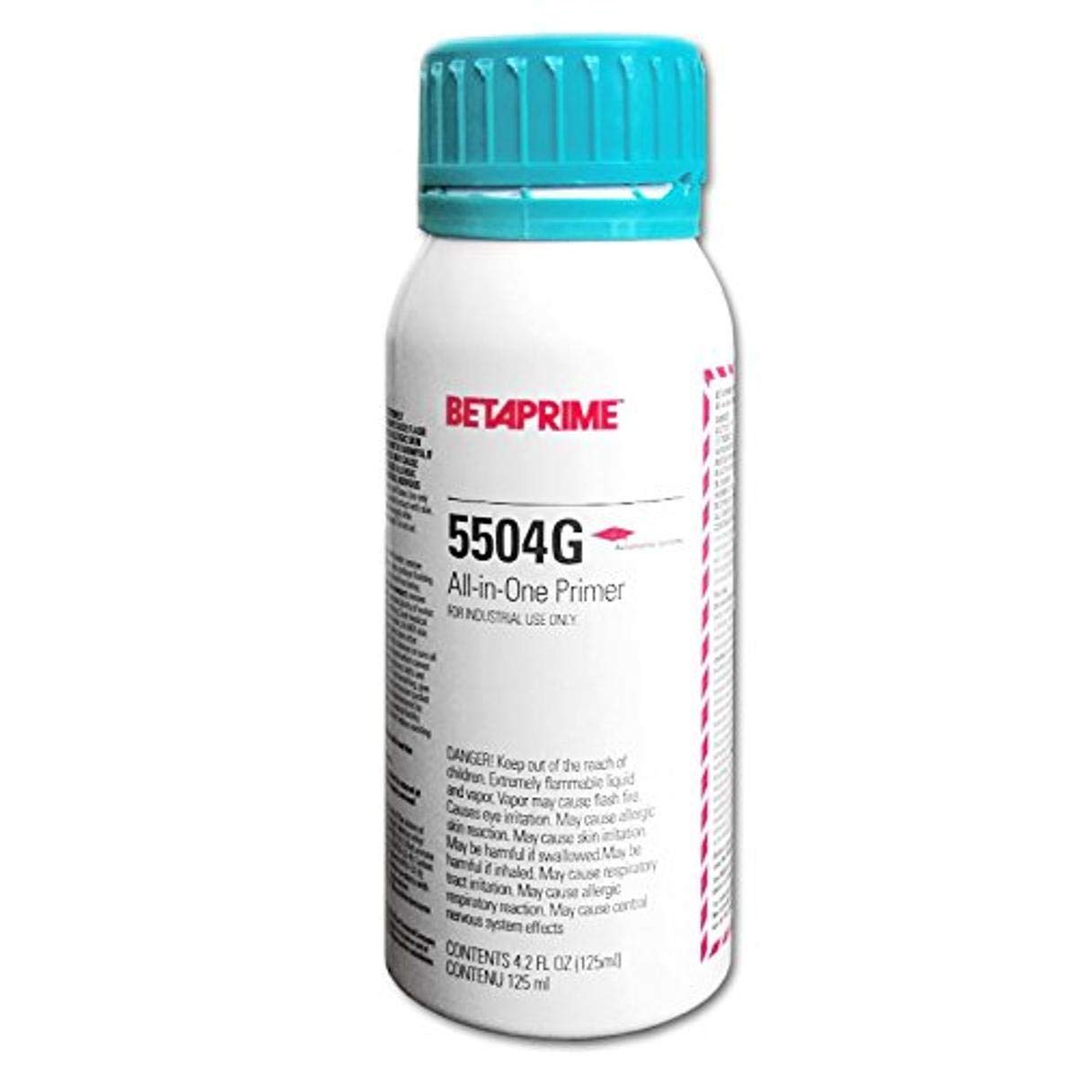

Glass shops use pinchweld primer to encapsulate rusty areas all the time.
While it won't repair rust holes, if the holes aren't much more than 50% of the pinchweld it should be OK. If you just want to keep the thing on the road a few more years, that along with the urethane adhesive will achieve that goal. Have some mobile installer come out to do the job. If they balk, maybe offer cash with no paperwork. Their concern is liability.
It looks repairable what I would do is get some of that spray that turns rust into a paintable surface and spray that on there and paint it and put the windshield on and seal it up really good. No need to scrap a perfectly good van over this.
No shop nor installer that had any clue as to what they are doing would apply that over rust. In fact it doesn't even go over clean bare metal.
Yes it means that once the corrosion is removed it can be used to treat the bare metal without another coating. You don’t put it over rust.
The problem is really that the rust isn't sound and has extremely low tensile and peel strength. Iron oxide is less dense than iron so as a result it easily flakes off. There is no way to cover it so that the structural bond between the urethane and the weld is maintained. Any rusty area will debond from the weld in short order.
Now if there are micro pits of rust in an otherwise healthy and clean pinch weld then maybe, yes you can encapsulate or cover those so that you'll get a good bond and stop the spread of the rust. But no way over a large area and no way over a weld that has a significant percent of the area affected by the rust. It just won't hold and will lead to what has already happened to the OP's car, and to mine.
