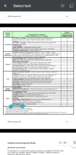

We're pretty strict on smog in CA; I think any modifications to the crankcase vent system will likely result in a failure during the visual inspection portion of the test.
Oil catch can/oil seperator should not fail for visual inspection. As long as it is sealed and using the proper hose(s), not using a heater hose type. It should pass.
