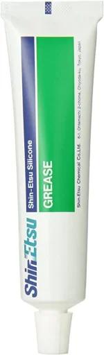

I use this, cheap and effective.
https://www.amazon.com/AGS-SG4-Lubr...t=&hvlocphy=9033430&hvtargid=pla-586191599437
I rub it on once a year (or two). Useful for many other purposes, too (I used it just today re-assembling brake parts after a wheel bearing change).
I like 303 Aerospace (quite a bit) forinside and certain things, but for door, trunk, sunroof, etc. seals I think this is better.
