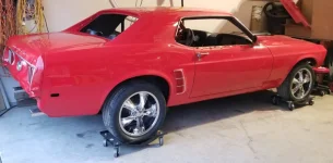

You don't know someone who has a wheel dolly?
Just lift the offending wheel, put the dolly under it, drop it down, and roll it into your driveway.

I do but once that hits the dip into my driveway and gets on the gravel it’s probably not going anywhere. Both front wheels are the problem.
Can you turn the front wheels left and then right, to access the bleeders. Would keep you from having to remove the wheels in the street.
Yeah I could have. Didn’t think of that 🙂😁😄.
