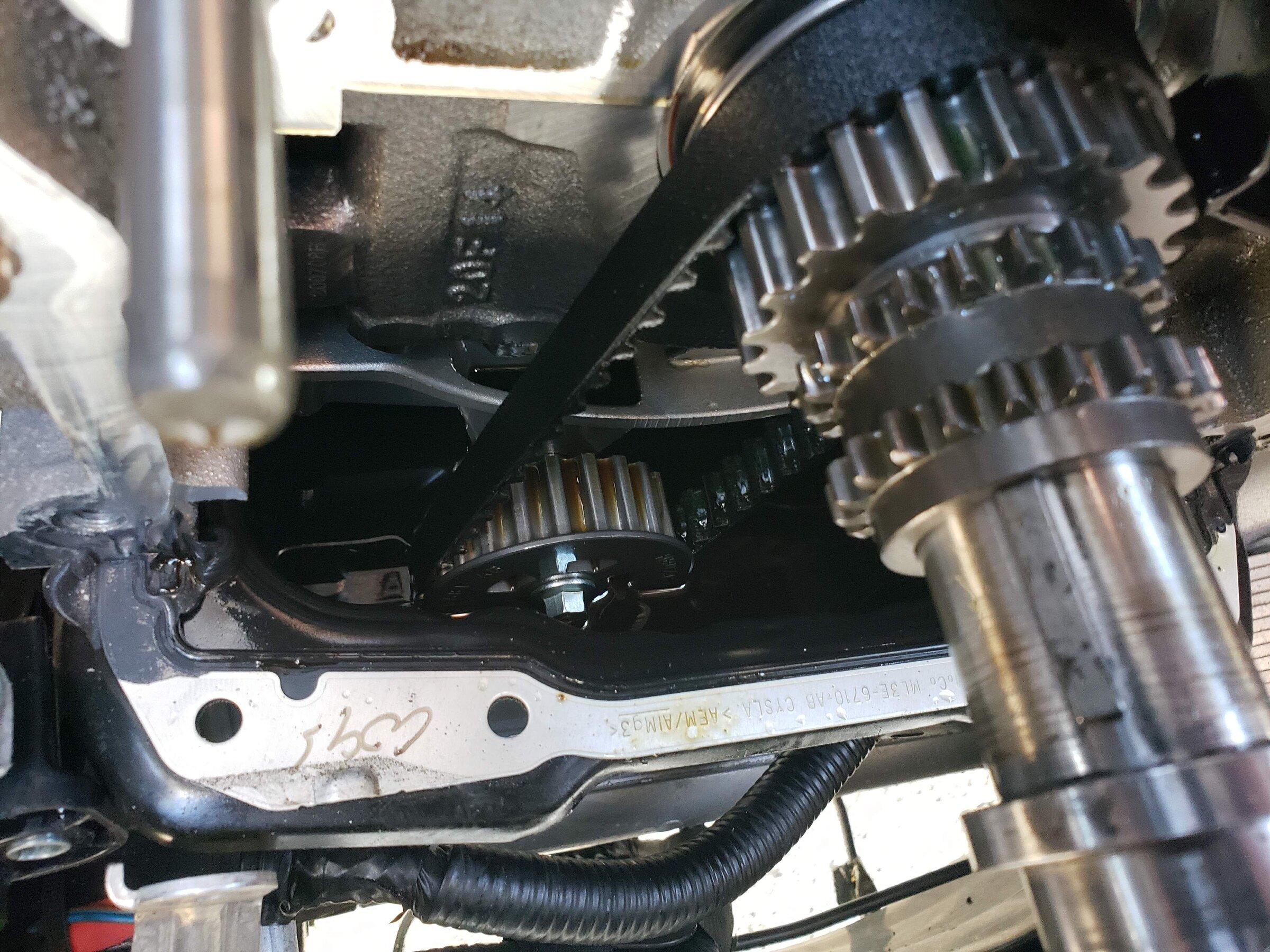

Here's the Ford 5.0L oil pump belt. You'll notice the pulley has a larger diameter than the timing chain sprockets. This is to reduce bending stress on the belt for long lifespan.
Earlier applications were not so well designed.
