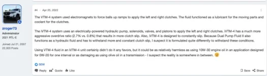

From the ridgeline forum -
The ridgeline should use the vtm fluid - that rear axle is basically a spool with electromagnetic wet clutches to either axle. It’s a different architecture than the dual pump differential used in the crvs. The service interval on the trhe dual pump system is quite short - if memory serves the Gen 1s were every 15000. We had a Gen 1 mdx with the VTM system (sh-awd) and I think the interval in that was more like 40k? And yes, VTM fluid came out pretty nice, whereas DP fluid looked beat up, every time.
