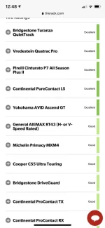

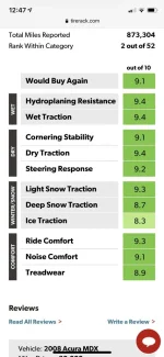

The Quatrac seems to be higher rated then the RT43 now. I’m highly considering these to replace my rock hard Michelin’s that slip and slide all winter long
