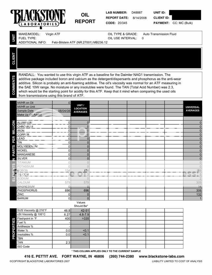

This is a VOA of Febi-Bilstein ATF that meets the MB 236.12 spec for use specifically in certain Damiler NAG1 transmissions.
It is blended by Pentosin - it is my understanding that it is the same fluid that is packaged and sold by both Mercedes and Chrysler (Mopar)
This fluid is spec'd for the NAG1 transmissions used specifically in the Chrysler Crossfire and MB/Freightliner/Dodge Sprinter, owning to special friction material used in the clutch packs in these vehicles.
