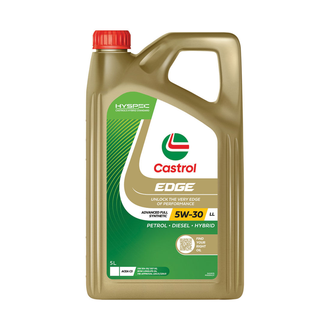

I don't know if you guys get this stuff, but here in Oz we get Castrol 5W30 LL (long life).
It's ACEA C3, MB 229.51, Porsche C30 and VW 540 00 / 507 00.
Link to Product Data Sheet
[Linked Image]
It's ACEA C3, MB 229.51, Porsche C30 and VW 504 00 / 507 00.
Typo fixed above for the Edge 5W30 LL, it's also API CF, if anybody cares.
Another low / mid SAPS oil from Castrol is Edge 0W-40 that's API SN, ACEA C3, BMW LL-04, Porsche A40, dexos2, MB 229.51, VW 502/505.
We also have the high-SAPS A3/B4 versions of Edge 5W30 and 0W40 as well.
