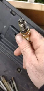

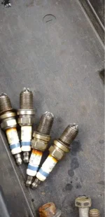

Extra photos. These are the “FUSION” brand platinum spark plugs I removed. PB Blaster I’m sure helped them come out fine.

Whoever put the incorrect plugs in should be hung, drawn, and quartered. I see much worse at work, but come on people; use the correct parts. also replaced hairline cracked PCV hose going from intake tonPCV valve. My cost for OEM part and clamps was $13~

Ugh, Bosch Platinums. The newest OE-style ones seem like a decent plug but I will never install that kind of plug even in a Chinese Harbor Freight Honda clone.
I replaced the plugs on my Tundra with Genuine Toyota Parts and they were only $1.66 each at the dealership, for 8 of them. What is the point of putting in non-OEM plugs in any Toyota engine, including a 2UZ-FE that only requires 4 spark plugs?
