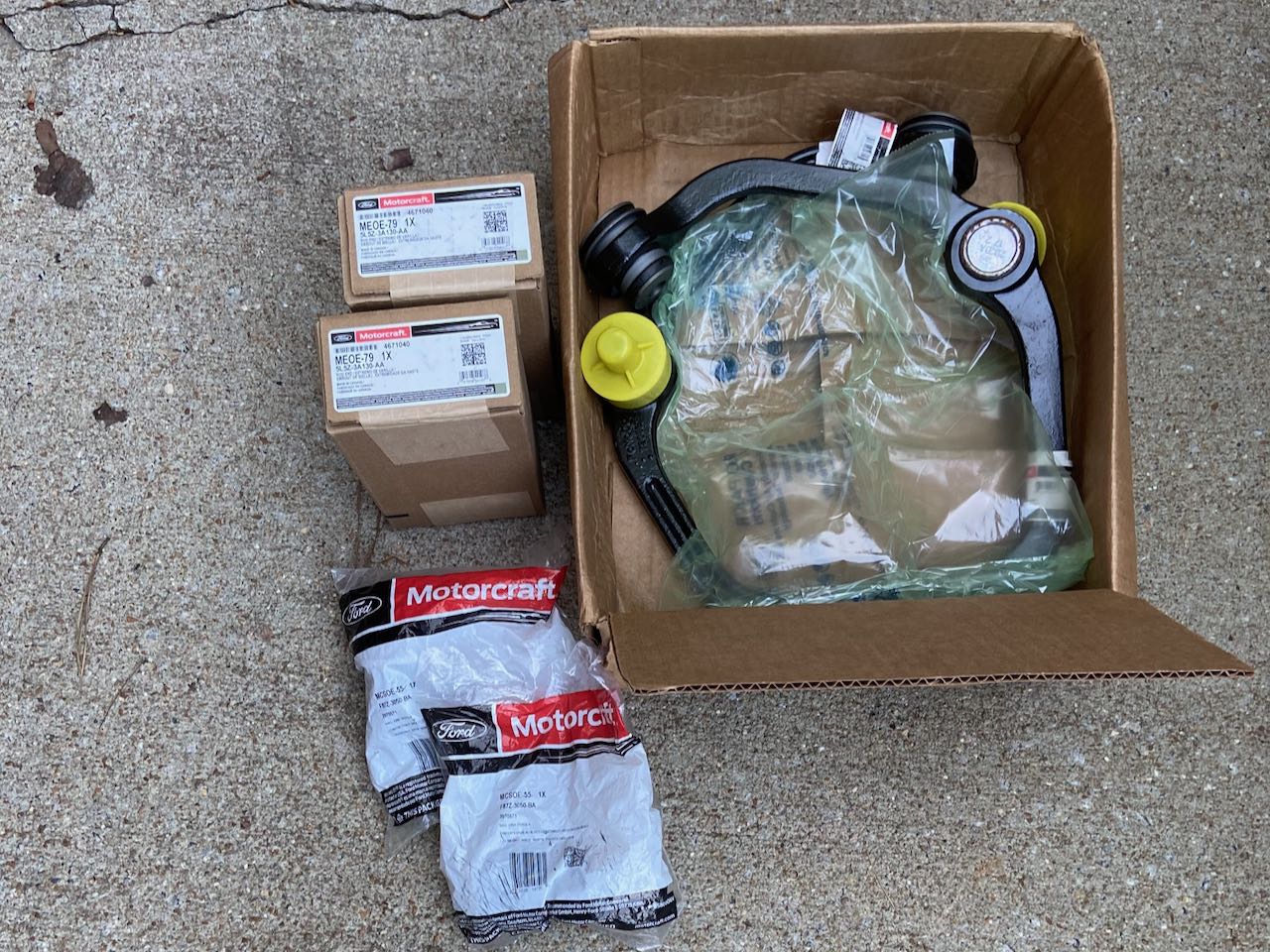

We use them all the time since they got rid of the caster slider years ago. Only issue I have had is with customers wanting the OE part and not understanding what a supercession is. Also the arms are different if you have coil springs vs torsion bars.

At 160,000 miles, I will most likely use OEM replacement Upper Control Arms.
Thanks for the info.
