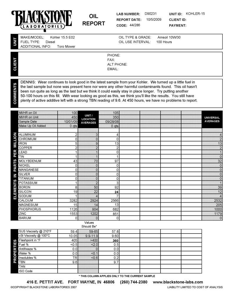

Below is a used oil analysis on my Toro 36 inch walk-behind mower with Kohler 15HP engine. The previous used oil analysis, from late September 2008, was using Mobil 1 Extended Performance 10w30. The current used oil analysis with with Amsoil MCT 10w30. Note the Zinc and Phosphorus - a really stout additive pack in this oil. Note that this engine has a pressurized lubrication system, on which I used a Mobil 1 M1-102 filter. Although I may have overestimated the hours this oil was in use (I do not have an hours meter), I am very impressed with the performance of this oil. This mower cuts about 10 small lawns (about .25 of an acre) each week. Oil has been in use since early Spring this year. Comments? I intend to stay with this oil.

Let me ask you 2 questions, did you have the Mobil 1 oil filter on there with the other oil and do you think your fantastic UOA has more to do with the oil meaning the Amsoil or the oil filter. If you used the Mobil 1 oil filter before then I would say it is the oil.
I may get this Mobil 1 oil filter for my Dad's Cub Cadet that has a Kohler Engine because the Super Tech oil filter was a pain to get off, I think it is because the oil filter gasket is cheap, I know the Mobil 1 oil filter has a better gasket so I will probably give this filter a try.
I used the same filter (as in a Mobil 1 M1-102, but the filter was changed when the Amsoil oil was installed) with the previous oil as well.
I would stick with this oil and take it out to 150 hrs then pull another sample, heck you could probably do 200 hrs.
NICE add. pack with the Amsoil!
HIGH TBN on both.
I may run it in my mowers also.

Amsoil MCT 10w30 is motorcycle oil, any reason this oil was used when Amsoil has a 4- Cycle 10w30 motor oil for small engines.

c3po - I chose this oil after consulting with Amsoil comparing MCT with ASE. I was seeking an oil that had similar characteristics as ASE but could last for an entire season of commercial grass cutting. Amsoil indicated that MCT was a better oil than ASE and that its TBN retention might be stronger than ASE. That's why I chose MCT...
I see your reasoning for using the MCT, thanks for pointing out the TBN retention, that makes sense.
