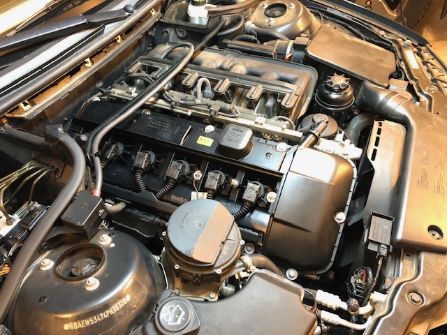

Had to replace the valve cover gasket due to a leak on my neighbor's 2004 BMW 330xi with the 3.0L M54 straight 6. This car has 76k miles on it, and has been doing the recommended 15k mile oil changes before I took over last year doing 6k changes with Castrol 0w40.
I also replaced the valve cover with one off ebay since these plastic ones are known to warp/crack.

Varnish from long ici's??
"Castrol Red"
Remember the vehicle has been driven on average 4,750 miles / year for 16 yrs. Oil changed every 3 yrs maybe? Meh nothing to see here.

Nah......Just Castrol marking it's territory!
Very normal looking m54. PCV should probably just be replaced if its history is unknown. It's cheap and not as hard as people make out.

That is one heck of a lot cleaner than the M54 that belongs to my buddy - his m54 is a basket case!
Tell your neighbour to research the conversion to an M50B25 inlet manifold - it has bigger runners so makes more top end power, and simplifies the plumbing tenfold.
