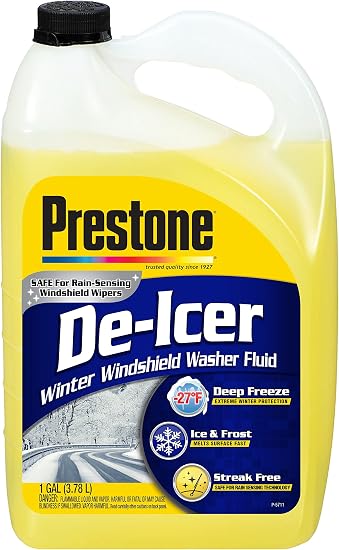

I've used this stuff @ -15°F with zero freeze-up issue at speed. The trick is to completely purge the washer fluid system before adding this; any old fluid (if lesser quality) will degrade performance significantly.

Butbutbut, the stuff below -20F rated has something "better" than methanol... apparantly ethylene glycol.
https://prestone.com/products?detail=AS250
http://www.kernair.org/Documents/MSDS/prestone de-icer.pdf

The SDS you posted is from 2006; this stuff had a -34°F freeze point. The product currently sold is at -28°F (per SDS), and omits ethylene glycol.
I've seen that Prestone booster with ethylene glycol aka coolant, and I also know that most owners manuals say not to put coolant in the washer fluid tank. So my question is, isn't the booster and any other washer fluid with ethylene glycol not safe to use in washer fluid?
So, can I buy a gallon of Methyl Hydrate for next to nothing and boost whatever fluid mixture is in the system with it? I imagine this would be more effective then spending on brand name mixtures that would be essentially the same?
I suspect the smallish amount of ethylene glycol has a synergistic effect with the methanol in dipping its freeze point. IDK how much cheaper it would be buying pure methanol from a paint store vs just getting the $2 jugs of blue stuff from the gas station.
I top off my reservoirs with the yellow stuff in the coldest part of winter. Makes it green, LOL. Seems to cut the flash-freeze when it evaporates on the windscreen, which is what I was going for.
I would be concerned about it leaving residue on the glass, maybe it isn't a problem at low concentrations.
