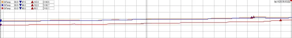

Here is middle east (Israel). So 0-20C during winter and 20-45C during summer at most extremes. Oil temperatures, however, never pass around 105-110C even on track.
45°C is rather hot. However at an oil temperature of just 110°C even a 30
would work ok. I'd still suggest using a fully synthetic 5W-40, ideally with
some reputable approvals such as Porsche A40, MB229.5 etc.. I too would
never spend $160 for 5 liters.
Btw, your (aftermarket?) oil cooler seems to do an amazingly excellent job!
Did you ever consider starting an oil import business?

I added a screenshot of telemetry from my last race showing my oil temps because I understand it sounds unreasonable 😅

The aftermarket oil cooler is just sat right next to the intercooler, is rather large and has an air tunnel forcing air right in it :)

Stunning. I'd bet any of my cars would have seen higher oil temps even though
all engines are bone stock.
