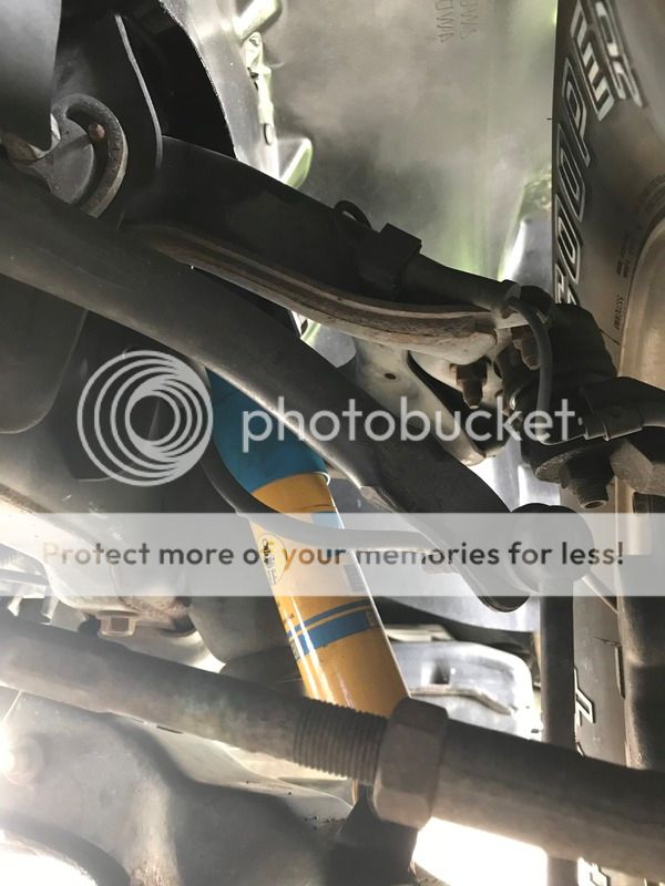

This would be my recommendation as well (4600's unless you need ride height adjustment). I chose the 5100's for my 2010 FX4 and could not have been happier with them.

I went with the 5100's on my f250. World of difference over the "Rancho labeled shocks" it came with (which still have "motorcraft" stamped on them).
The Bilstein 5100 monotube are perfect in these big vehicles, they are a bit stiff in the rear for unloaded pickups but the additional weight in the rear on the SUV smooths them right out, they give the SUV a Euro style ride which is well controlled without being harsh.
